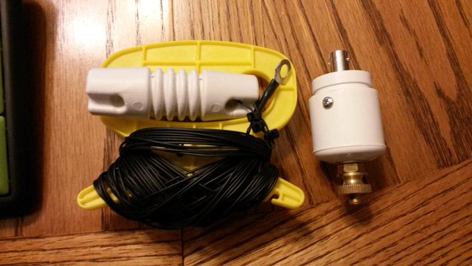

    Here I am trying out the Spark Plug Antenna.
    Trying out my new Spark Plug Antenna. It's another EFHW.

    A better experiment might be to try a comparison of using just the wire as the antenna versus having the Balun (or is it just a base loading coil?) attached. I can’t imagine the Balun is making all that much difference… Seems to me it’s more of just a way to attach your antenna wire to the radio. An A/B video of with and without Balun might be more revealing
    Just a thought - nice video
    Dave

    That is a neat form factor for a bnc mounted 1:49/1:64 autotransformer used with an EFHW. For POTS/SOTA use, this is really nice as it's compact and tidy. It's great to see the experimentation and the market for this part of the hobby is alive and well.

    The end fed half wave has a very high impedance at the feedpoint, so the 49:1 un-un on this 'spark plug' transforms the impedance of the wire from about 2500 ohms to about 50 ohms that the radio is looking for.
    Thanks for watching.

    That's not an antenna, that's a balun. Not that wire is hard to come by, but if they're going to call it an antenna they should at least supply the wire with it. It is a pretty neat design, though, and I wouldn't mind trying it out.

    Here is one of a similar form factor, courtesy of N5JLD:

    It is also available as a full kit with wire and winder. They weren't available when I bought mine.

    K9KMV said it correctly. It is a transformer that takes the high impedance of the voltage max and takes it to about 50 ohms. You still may need to further choke the coax .
    This particular transformer won't do well with high power, but that is so noted.
    End feeding dipoles, for example, is a fairly modern approach brought on by lower loss materials and the availability of ferrite for chokes. The downside is the high voltages can make things burn up with overheating or even wet conditions. BUT this is rare...

    I use one that came in kit form from KM4ACK, similar to this except the toroid and capacitor is mounted on a 3D printed kite winder. Easy 30 minute build, winding the toroid takes some care but the rest is easy. I got similar results to you, the kit included about 68 feet of the 26 gauge polystealth wire and I ended up trimming about a foot and a half to bring it into resonance on 40. 20, 15 and 10 looked good too. I had it running from a 25 foot fiberglass pole sloping down to about 10 feet to our back deck. I made contacts right away with my 705 at 10 watts SSB. Haven't been to the park yet, but that's next.

    The EFHW antenna can be quite effective - I use one here at home with very good results. In the interest of correctness, the matching transformer is actually a UNUN - UNbalanced-to-UNbalanced rather than BALanced-to-UNbalanced.
