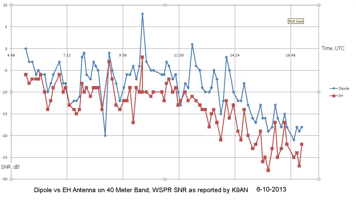

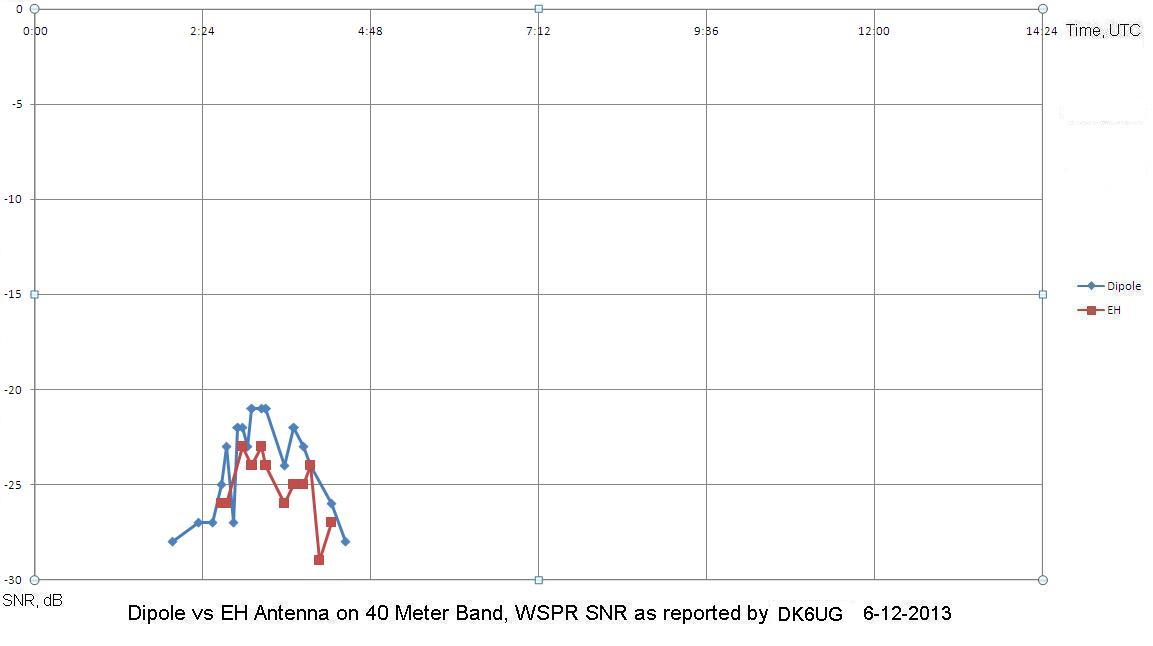

    Julian, here is a webpage showing the results of what I term "comparative antenna testing" where the accrued WSPR SNR data from the two antennas under test as received at various spotter stations were plotted. The two antennas under test were excited simultaneously (this works to offset varying ionospheric conditions that affect propagation over time) with WSPR signals from two transmitters separated in frequency by about 100 Hz or so in the WSPR band :
    http://www.qsl.net/w/wb5wpa//EHantenna/EH_Mark_2_Vert/
    Just two quick examples of data plots :
    The K9AN station is 1086 km at 42 deg AZ from transmitting station WB5WPA

    DK6UG at 8225 km and 41 deg AZ from transmitting station
    I won't go into details how all this was accomplished (or what caveats should be observed on several fronts), as that would be too big a diversion on this thread.

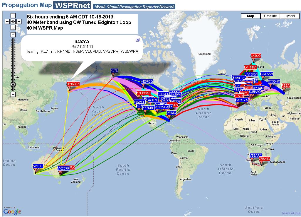

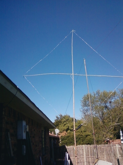

    Julian, those are a good start for evaluating a "turn key" commercial product that targets a particular user (or product) demographic. Most of the work I've done the last few years has been in the vein of "proof of concept" evaluation of various 'raw' antenna types like the EH (and spin-offs), the DLM (by Robert Vincent), various loops etc. where final 'form factor' and beauty is not a design or targeted consideration!
    Quickie lash-ups like this design that used cheap 17 ga (.045 inch) AL wire, 10 inches of 1 and 5/8 inch Andrews Heliax tie-wrapped to some locally-grown cane (bamboo) poles :

    Sometimes I can't tell if my friend and big crazy neighbor Jim is making a joke or not (j/k about that "crazy" part :):eek::))
    As you may recall, I did model it, but I'll be darned if I can find the saved results. :( If memory serves, recall that it matched up well with all that data we took on 160 M and 80 M WSPR. ) It was a capable antenna that took advantage of that handy r^4function of loop radius vs. loss, and ended up at only a negative few dBi - very impressive for such a relatively small antenna, especially on 160 M :)
    We may have disagreed on this part however, the originating idea on the edginton website about some mysterious "new loop excitation method" was mostly wrong :( IOW, the loop works well!, but because of our r^4 friend in the loss equation, not some mysterious new configuration.
    For me, I recall 2 "bottom lines" - 1) is that it pays to think about mid-sized loops that gave Jim a pretty nice 160 M and 80 M footprint from a small antenna - and - 2) "model this" worked out quite well :D - although it took a fair amount of time a forum bandwidth to resolve the extreme common-mode issues with the measurement...
    Although the highly imbalanced feed on Jim's (old?) loop was at first tricky to get the measurement to match up to the model, in the end, it matched quite well:rolleyes: - as it ALWAYS does when the details are properly accounted for ---- including as discussed on this thread above, the use of ALUMINUM for the loop material as instead of copper for the STL's / mag loops ....
