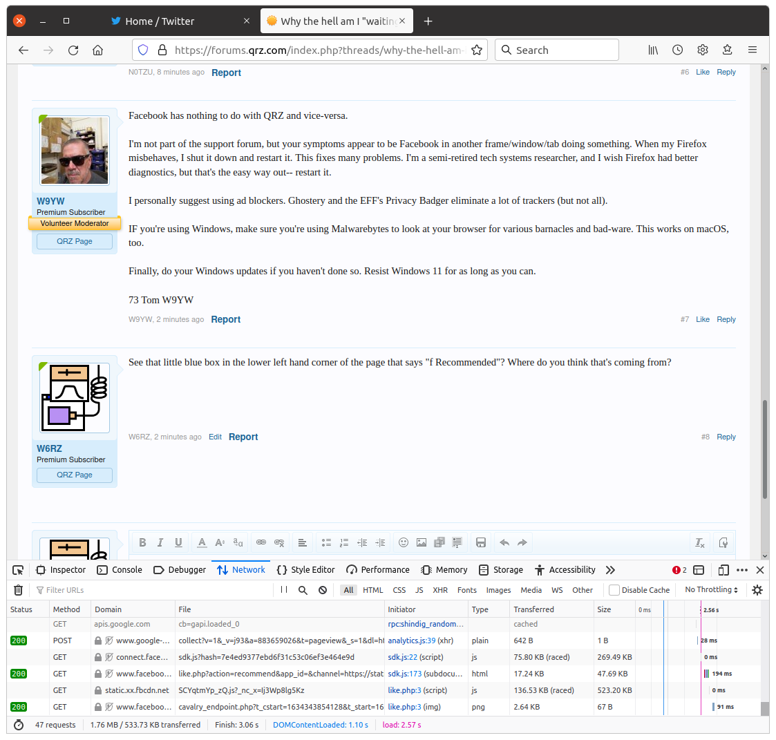

    See that little blue box in the lower left hand corner of the page that says "f Recommend"? Where do you think that's coming from?
  9. W6RZ
    W6RZ Premium Subscriber QRZ Page
    You can use the Firefox Web Developer Tools to see what websites you're accessing when you load a QRZ page. Some Facebook sites get accessed on every page you load on QRZ.

    Look at the bottom left of the page, do you see a Facebook "Recommend" button underneath "Share This Page"?
    Ack, W6RZ beat me too it. There are lots of services being loaded - facebook, googleleads, etc. You're not just connected to QRZ.com. My load of this page shows 43 separate requests being made to construct the page.
