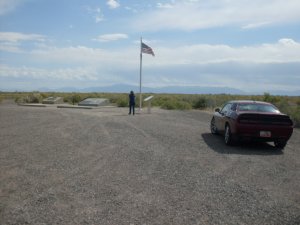

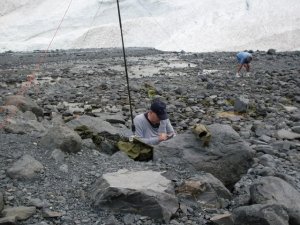

    Currently I run a KX-2 w/internal tuner, or a SW3B with an external tuner.
    Why? It is so much faster to throw up a wire - where that is even possible - match with the tuner and get on the air. Load up the vertical, the same.
    Some -places you are just not going to be able to put up a wire - nothing is there, and the flagpole is a non-starter.
    or
    no trees at the base of a glacier.
    As noted, the time and effort to put up a full wire antenna, esp with a multilocation field trip, is simply not going to happen.
    I would point out many QRP rigs sold today come with a tuner as at least an option. The KX-2, the now deprecated PFR-3(a), and others show this to be the case.
    Again, if you are wandering thru a location that is new to you, you likely have no idea what is to be faced when putting up an antenna.
    To me, it is better to have a wire and/or a collapsible whip, along with a tuner than to hope for a tree that will support a pre-cut wire antenna.
    IOW, a tuner gives an operator that maximum flexibility to work HF in a new or unknown location.
