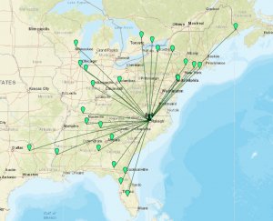

    I have had zero issues with my silver bullet WRC. I just spent two hours at 90 to 100 watts SSB and 75 watts CW on 20 and 40 meters and the contacts were excellent. Checking the coil from time to time it was never even warm. I did spend the time with an SWR meter to make sure it was tuned properly beforehand. I think that makes a big difference. Here is just the 20 meter contacts @ 90 to 100 watts.
