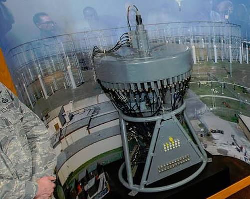

    Finally, if you have ever seen a "Elephant Cage" facility (AN/FLR-9) - the hut in the middle held the rather large Goniometer
    [​IMG].
