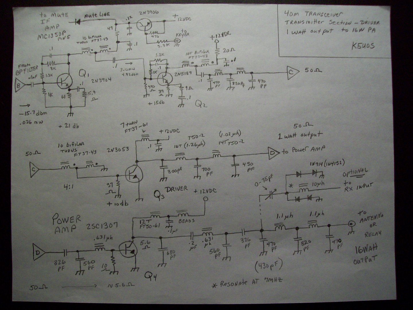

    The use of diodes for front end protection is popular with many home brewers. The first time I saw a circuit with diodes used this way was in W7EL's Optimized QRP Transceiver back in the 80's. One major benefit is that it is simple.
    http://www.arrl.org/files/file/Technology/tis/info/pdf/93hb3037.pdf
    I use the circuit in a 20W homebrew 40M transceiver. In my circuit when transmitting the diodes ground the 0-75pF trimmer and the trimmer becomes part of the low pass filter when paralleled with the 430pF capacitor to equal ~470pF.
    During receive the 10uh inductor and the 0-75pF capacitor form an approx. 50ohm series tuned circuit to my receiver. It works very well to protect my RX front end and provides nice QSK operation.
    It is not likely that the OP will be considering a 20W input to his front end. The signal will be strong but not that strong.
    Inexpensive 1N914 diodes work well.
