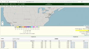

    750 mW from a 12A7 Colpitts crystal oscillator (that keys perfectly, BTW), subtitle "Why 80 for Regional QRP?""
    Antenna is a low/bent/drooping 100-ft doublet center-fed with window line. Comfortable two-digit SNRs.
    G3EDM and N8TGQ like this.
