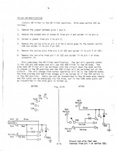

    It's going to be my AM squeeze. so it's getting an Inrad filter and a few nips and tucks in the wiring to make that go.

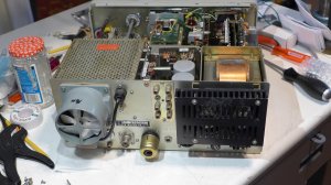

    It's really in good shape. The finals are well loved but not burned. More to post as the project moves along.
    There are a couple of dents to pull and a fan to oil but this thing really looks fine. I think it's going to clean up to spiffy.
    It easy to see whey this radio has a devoted following. It's built like a brick outhouse. What's your experience with the FT-101 family?

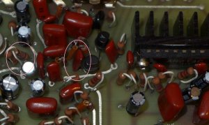

    Also, inspect the small, flat green and brown capacitors on the Circuit cards. I have seen some (but not all) radios who’s capacitors have split, presumably due to prolonged exposure to excess heat.

    These are the shiny caps and they seem to have a better survival rate than the flat ones.
    There are a few cracked ones so I'll take a close look all over.

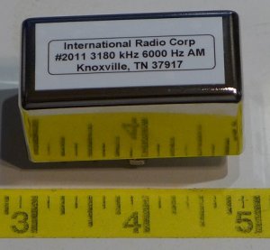

    I purchased an Inrad #2011 a few years back when there was talk of discontinuing this filter.
    The radio I picked up has this filter already installed (rather poorly... I've reworked the wiring already).

    Copy you on the sweep tube finals! The previous owner mentioned that the tubes were a bit "soft" and I'm planning on putting in a fresh set with new suppressors once this radio is tuned up and ready for action. A critical eye at the final cage reveals that it's been hot in there... I'm finding nits to pick while going over the chassis. So far, all of the parts I've needed are in stock here (a few cracked Mylar caps and a damaged resistor).
    I'm planning on running it at about 12 watts into my AL-80B eventually when everything is going well.

    Yes, that is exactly the type of cracks to which I was referring.
