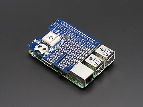

    Best add-on for the HamPi, especially for Digital Modes and Satellite Tracking is the $60 GPS hat that plugs directly into the GPIO bus on the Pi:
    https://www.amazon.com/gp/product/B00S7FAJC4/ref=ppx_yo_dt_b_asin_title_o00_s00?ie=UTF8&psc=1
    Shown here (the Blue PC Board) plugged into the Pi
    For $60, and 30 minutes of time following simple Debian programming instructions available on YouTube you
    can have your own STRATUM ONE time server, the Hat synchronizes time with satellite constellations (via included window
    antenna) and passes PPS Pulses (at STRATUM 1) to feed the PI's Real-Time Clock. Take another 20 minutes to configure
    an NTP Server and pass STRATUM 2 clock signals to your entire network.
    It's amazing how small and inexpensive these units have become. In the military we needed precise timing to synchronize our comm/crypto gear, the units were fed by PPS pulses produced by Huge Cesium clocks the size of a small refrigerator. The Cesium clocks are gone from the scene, we now install GPS based clocks at military bases; while the physical footprint has been reduced to the size of DVD player, the commercial GPS versions still cost upwards of $20K, mostly due to the downlink encryption
    With the PI + GPS HAT I have the near-equivalent accuracy of WWV on all NTP devices in my shack, and only for $60! Ensure that the GPS Hat board you purchase supports PPS, it's not always clear in the listings.
