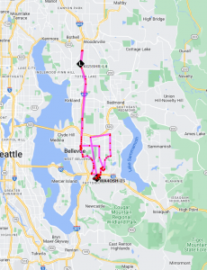

    Keep in mind that LoRa has about 15dB of process gain. It can receive signals that are SNR -13dB without problems. That's below the noise level. It really does not need a 20W amp like conventional APRS does.
    I'm in the Seattle, WA east-side (Kirkland, Bellevue, Redmond) area. We have 90-125ft fir trees and hilly terrain. We have deployed a few iGates in several less than optimal locations. I regularly get 8-10 miles tracking a T-Beam tracker with a 2W antenna into a roof top mag mount antenna on the way to and from my work in Redmond.
    I've also built a mobile iGate using a T-Beam where the iGate is tethered to either a public WiFi location or to a cellphone. As the location changes, the iGate updates its lat-lon location from the GPS.
