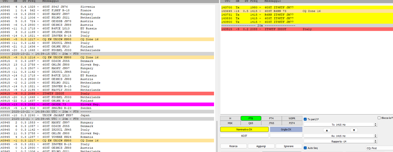

    I try to contact and i receive a IDIOT as response ??
    Who do you think your brother is? How dare you,
    you could send a message and explain why instead of talking nonsense.
    We are not all as expert as some, you could have sent a message and explained the reason..

    Sorry you received this message; however, you were transmitting in the same time sequence as the 6O3T station.
    Your receive window in the even sequence shows that you were NOT receiving 6O3T.
    If you can not hear them, then you can not work them.
    Tom
    K5TEE

    A good way to avoid being on the wrong time slot is this: when you see the DX transmitting, choose a frequency that is not busy on the waterfall, and then double-click the line where the DX is transmitting.
    Good luck!

    I didn't know that transmitting in the same time sequence as the 6O3T station ""At first I received them, I replied to the cq but then I only realized now that I no longer received them and the software made the 3 calls"" it could cause problems. I'm new to FT8. They could have sent me an instant message here on QRZ.
