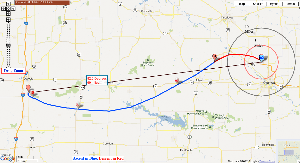

    The other exciting mission to this launch, and the reason we are calling is "X" Marks the Spot is because we are going about this launch a bit backwards to what we have done thus far. For an added twist of difficulty, we have preselected our desired LANDING location, and will be calculating out LAUNCH location based on continued calculated predictions right up until we launch. We have chosen the Ottumwa Industrial Airport - KOTM as our "X". This will challenge our Propulsion Team to hit their mark!

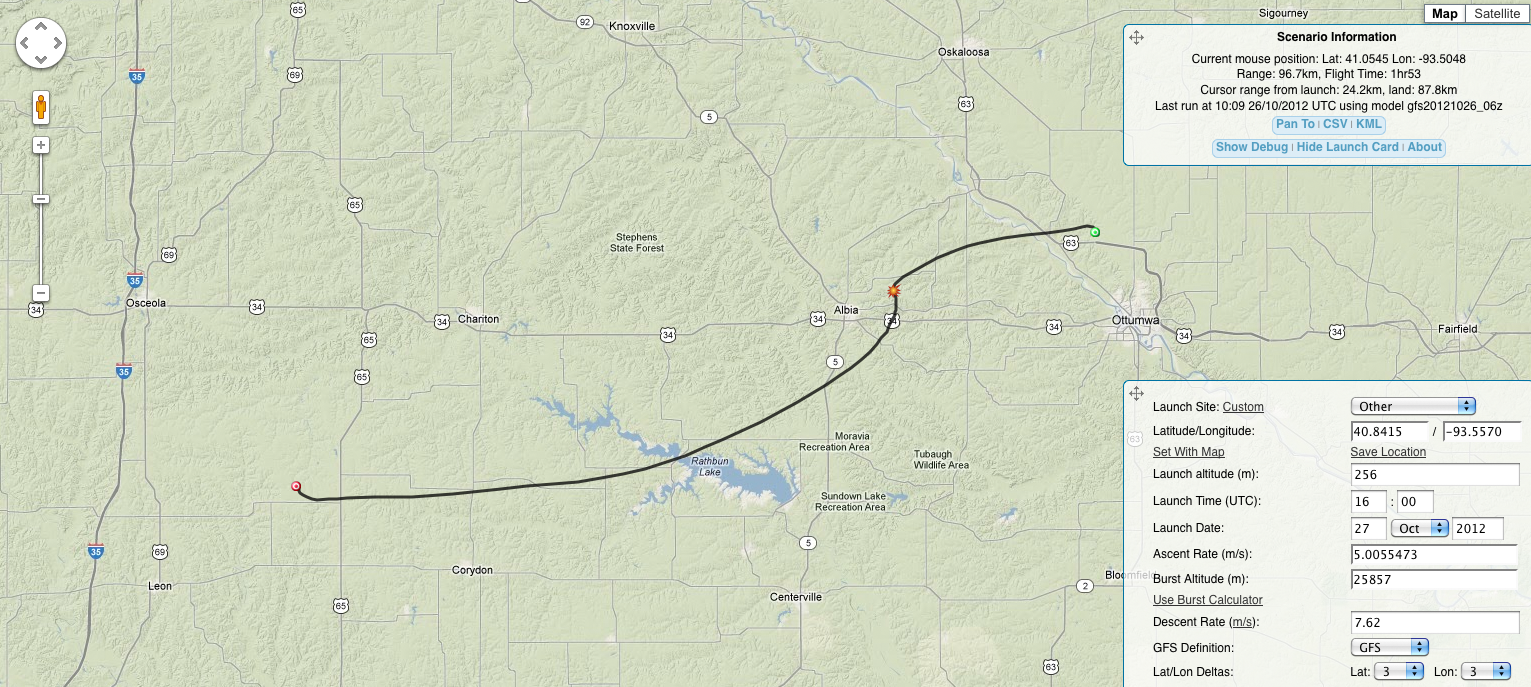

    As of 10/26/2012 0245Z we "Go" for launch at 1600Z. Flight weather briefing is complete and NOTAM has been filed. Weather looks COLD, but DRY! Live audio is being steamed to the Mission Control Live! Tracker -> HERE.
    Latest Predictions:
    http://www.ihabproject.com/iHAB-8/La...n_10262012.png
    http://www.ihabproject.com/iHAB-8/La...H_10262012.png
