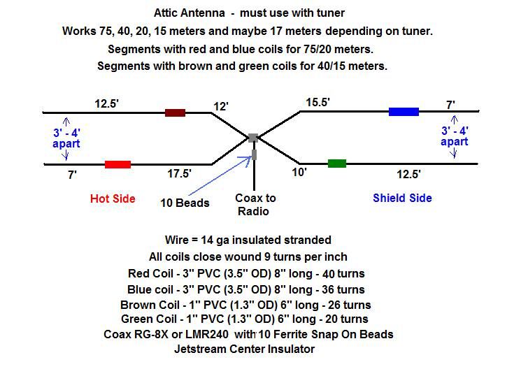

    Because you are dead set on a coax feed, I'm with NY3V's suggestion: "You can add and fold back about 7' to both ends of a 52 foot dipole to give you the required length for 40 meters, and add a 20 meter dipole to the same feed point". You should end up with a good 40/20/15 antenna. The radiation pattern on 15 meters may have additional lobes.

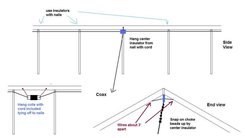

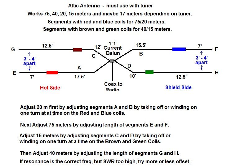

    Wire is insulated stranded 14 ga THHN.
    Leave off the beads and the Jetstream center insulator, and instead use a 1:1 current balun. I like the Buxcomm B15C11.
