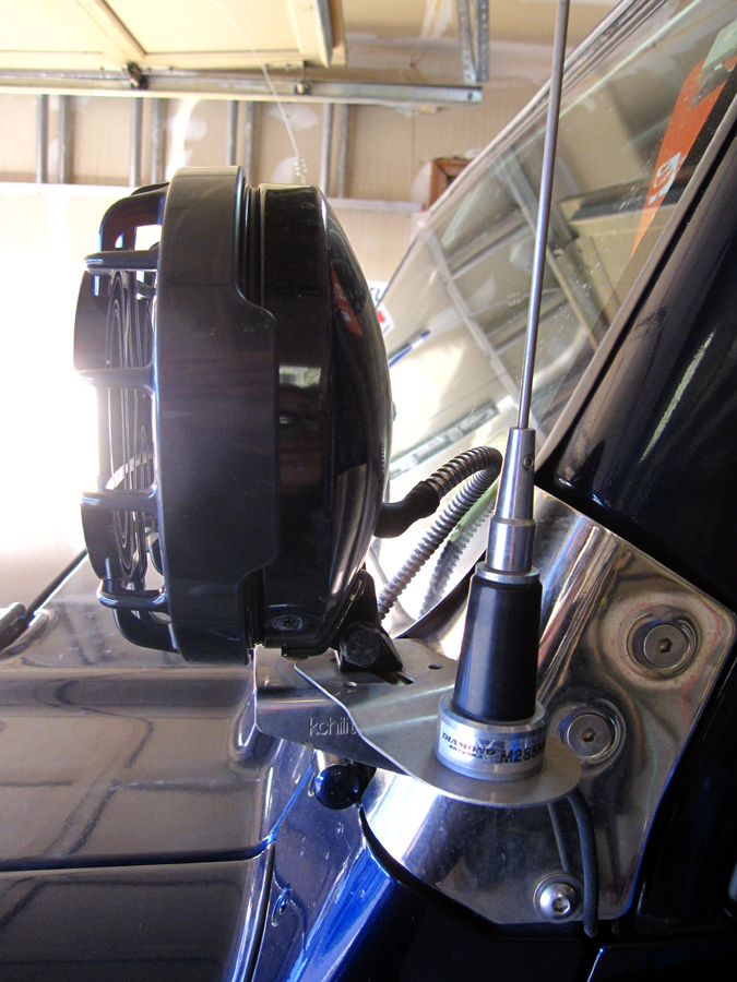

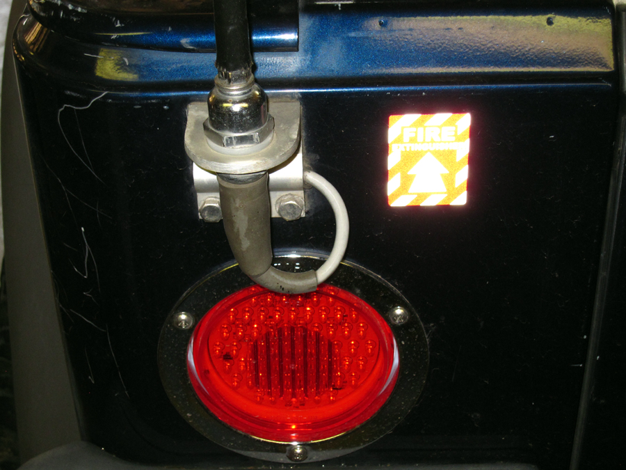

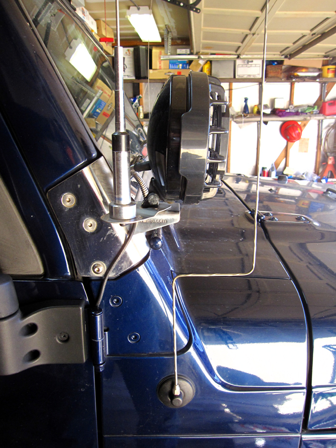

    For what it's worth. Why not leave the mag mount for the other vehicles with the steel roof/trunks and do a permanent mount for the Jeep? If you had both of the same mounts for permanent/mag mount, then you could just cap one off while you used the antenna on the other. Or have two antenna.
    Here are a couple pics of what I did on my Jeep that has the same type of fiberglass top, sometimes a soft top or nothing.
    They have worked great, with great reports, even on distant repeaters. 2m and 440.
    And for the 11 meter...
