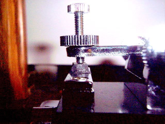

    Hi,
    Went to Harbor Freight, bought a pack of super magnets and a package of suber glue, each cost a dollar.
    I then took the spring out of the key and forced a nut onto the spring adjusting screw, grinding away any protruding tip. Then one of the magnets was glued to the nut and one to the base plate cavity where the spring used to be. I then added three more magnets to the base, not glueing these, just letting them snap into place.
    The reason for not glueing the last three magnets is that they can be removed one at a time to give a different adjusting range. You must make sure that the magnet on the key adjusting screw and the base repel each other.
    After adjusting all settings the key works very well and the hard required down pressure of the spring is gone.
    73 WD8QXP

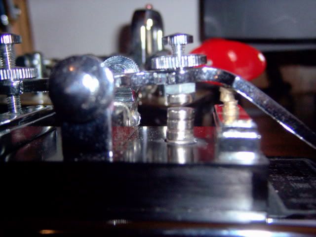

    Hi,
    This modification should work with just about any key. I applied the mod to a sounder key combo. It had an great key on it. I just put the magnets where the spring was and it turned out to a super key.
    Thanks WD8QXP

    Hi,
    Here is my final key modification. I added a rubber pad underneath the back stop screw using super glue. I am using just two magnets in this key. The addition of the rear rubber bumper realy cuts down on the noise generated by the key. It is quiet, solid and smooth. Very easy to adjust and if more tension is desired just add one magnet to the base.
    I enjoy all the responses. I am getting on the air now, using low power.
    Thanks Helmut

    I would love to see some pictures of this modification.
    David
